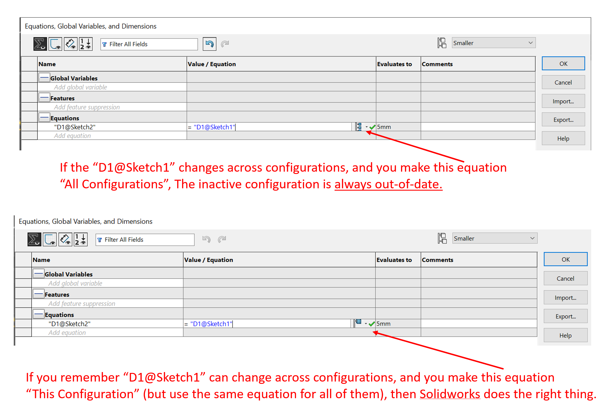

I’ve attached toy example (created with SW2020sp05) consisting of two sketches and two configurations. Sketch one has a configured dimension, and sketch two has a length set equal to the configured dimension in sketch one.
Every time you switch between configurations, the “checkmark” will disappear from the inactive configuration. I would expect that the rebuild order would be deterministic and noncircular. Sketch1 should solve first (using the configured value), and then sketch2 should solve using the value from sketch1. Maybe it works that way under the hood, or maybe not, but in any event, the “body data” of the inactive configuration is marked out-of-date, so if you use this sort of workflow in a bigger part or assembly, you’re in for a world of pain.
Looking at this a little more, it appears that if I mark the equation “configured” (but use the same expression for both configurations), that will resolve the issue. Marking that equation as “configured” must alert the internal data model of Solidworks that “hey, the value calculated by this equation” may vary across configurations, so expect that, and don’t invalidate the other config just because it changes.
That little adjustment fixed everything. It feels a little like embedded systems firmware development, or something, where you need to mark as “volatile” any data that can change in ways unrelated to the execution of the current code scope, to prevent the compiler from making too many assumptions about them.
So here, you need to mark as “configured”, any equation who’s calculated result can vary across configurations. It makes a certain kind of sense, so I wonder if that work-around it might have worked in the example in Alin’s talk.
This also seems like something that could be built into automated model checkers, or something. Just activate all the configurations, and see if the values of any equations that aren’t “configured” ever change across configurations. Any takers from macro authors?
