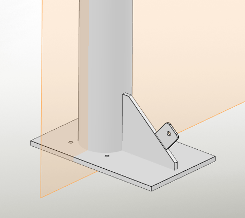

FYI: If you are running in ‘Software OpenGL’ mode, you are basically not using the graphics card to do any of the graphics processing mathematics. The CPU is doing it all and telling the graphics card, ‘Here. Display this’. Things may look better in this mode, but performance (rotating, large assemblies, etc) will suffer and you are simply sidestepping the underlying problem. I posted a question about issues with this card in the SWYMP back when I got a new Workstation (441.66 drivers) and was test driving SW2020. I was seeing bad aliasing and washed out edges:
Notice the rear vertical edge is nearly invisible at the top, and then becomes more visible and then disappears again.

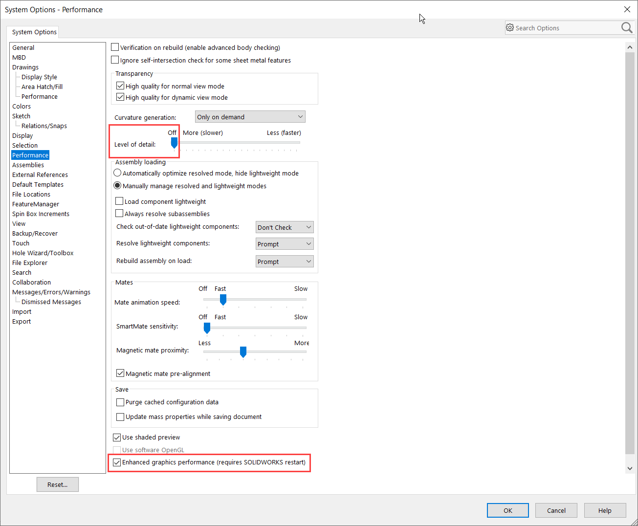

With modern video cards this can be eliminated by applying these 2 settings:
Also make sure the Transparency boxes are both checked or unchecked.
Alin thank you! I am going to test it asap!
OK, I tested the setting with a QUADRO P2000 and it does not work…maybe that videcard is too old?

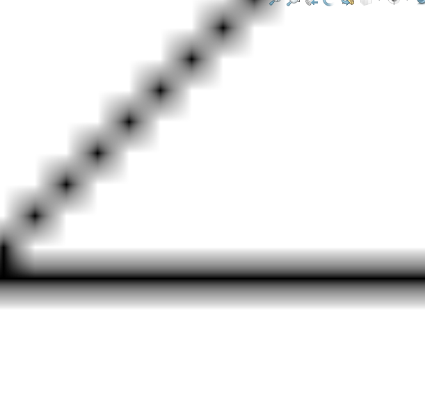

Is that a screenshot of a Drawings view? Is the view set to draft quality?
Alin
the screenshot is a portion of the screen during a zoom in with mouse wheel. all the views blur like that and come back to normal in about 2 seconds.
all our drawings are made WITHOUT draft quality. And every time I analyze a drawings is the first thing I check. I never saw a view set to draft at my company, but this blurring happens anyway. for small drawings it is barely noticeable.
If I set software opengl the zoom operation does not blur (this is coherent with what is written in the KB) and it performs better that opengl imho.
