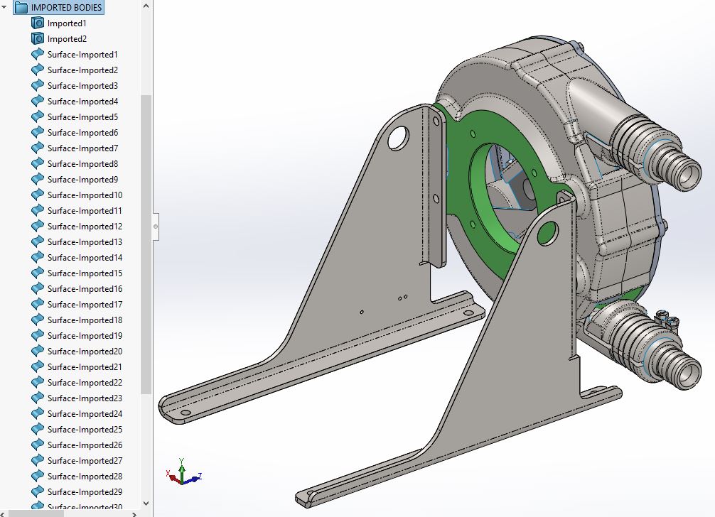

It’s not magical. It’s relevant and useful. I’m not making the thing. I’m making a bigger thing with this purchased thing in it. I could care less how internally messed up it is. I DO care about a few things: where does it mount by bolt down holes, where do its connections go, how much space does this take up to obstruct movement of other things.
Turning off irrelevant errors helps reduce delays in (large) assemblies and drawings which contain this product.
This is an example. The brackets are the two solids, and all else are surface bodies. With VOR on, I get a half dozen errors on surfaces. All I need here are bolt downs, motor attachment, and hose attachment locations.
