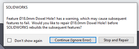

Is this error message in your list of dismissed messages? If you check the box “Don’t show again” and then click “Stop and repair”, every time you have an error in the tree the rollback bar will automatically go back to the error. Basically the exact behavior you are describing.
I have a love-hate relationship with “Don’t show again”… You ABSOLUTELY MUST know 100% what you are doing when you check this box! Otherwise SW will never present you with the option again, and you will struggle forever.
Go to Tools->Options, System Options tab, Messages/Errors/Warnings, Dismissed Messages. This message should show up somewhere in the list. Put a checkmark next to it. And while you’re there, place a checkmark in every box there that you don’t ABSOLUTELY 100% UNDERSTAND EXACTLY, PRECISELY WHAT IT IS AND HOW IT AFFECTS THE WAY THAT SW WORKS!!! You might find some other SolidQuirks boil down to a PEBCAK error.
So true. The one that really would get us was the "Unable to locate the file “xxxxx.sldprt”. User would “suppress” the missing files and check the don’t ask me again option. Then come to me saying they don’t know what’s wrong with SolidWorks, its no longer asking me to find missing files. Well, you told it to suppress missing files and to never ask you again. I get why it happens, you’re in a hurry and just want to open a big assembly and not worry about a few missing parts. At least the newer version of SolidWorks added the option suppress all missing parts…but that damn checkbox is still there and users inevitable select it.
I know it would be a huge undertaking, but I would love to see two options on every one of those dialogs - “Don’t ask again in this session” and “Don’t ever ask again”. Then some sort of additional explanation and required extra user confirmation would pop up for “Don’t ever ask again”.
Had that issue with a new guy that started a few months ago. He dismissed every warning that came up and checked the don’t ask again box.
He would rename some folders and moved parts in windows and then was going crazy when his assembly only had a couple of the parts in it and he had a ton of mate errors.
I have to admit that I actually did think that selecting “don’t show again” would mean that it would not show it again for just that session. Then in the weeks and months afterwards thinking I don’t remember seeing that popup warning like I used to see, so thanks for the explanation.
As you say above having two different options for “Don’t ask again in this session” and “Don’t ever ask again” would be an excellent option to have.
