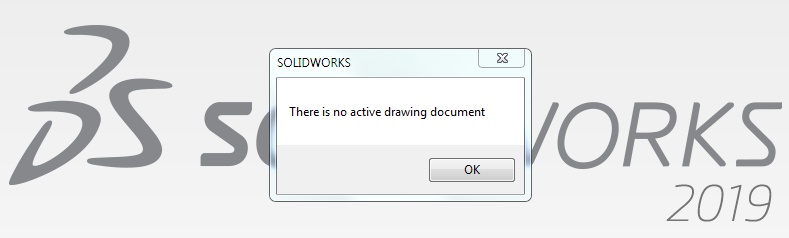

The macro would check for all open files and would process only drawing files. In case there is no file or no drawing file (will check only the drawings which has been saved), it would prompt the user.

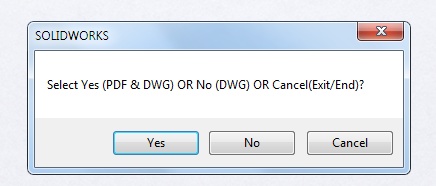

If macro found a drawing then it would prompt user if he/she wants to export PDF & DWG both or only DWG.

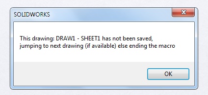

If a drawing has not been saved ever, macro would skip that drawing and prompt the user. This would happen in case there is more than one open drawing and some of them have not been saved.

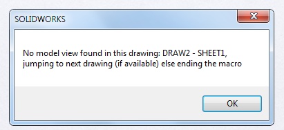

If there is no model view found in a drawing, macro would skip that drawing and prompt the user.

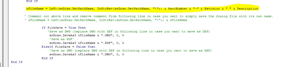

The exported PDF/DWG file name would be based on Part Number, Revision and Description custom properties values from the model. So make sure your model has these custom properties with values.
If you want to keep the same file name, then comment out the highlighted line and use the other line.
