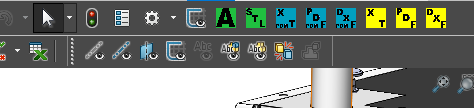

I just upgraded to 2022. After the upgrade I opened solidworks and restored my saved settings. Everything looked fine, except the custom macro buttons I added to the toolbar were missing. After some google searching, I found the solution is to run the “restore settings” wizard with solidworks closed. When I did that, the next time solidworks opened the buttons were there. I just wanted to document this in case someone has a similar problem in the future.
