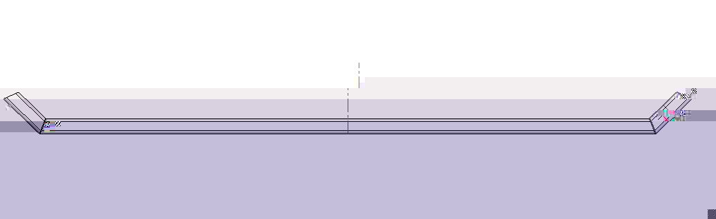

Im needing to model the following type of 30x30 RHS Box Section.
We’re intending on getting it laser cut (so the V notch cutouts will be up to the inner wall of the RHS) & the idea is that when it comes in it can be bent to the shape shown in the 2nd image.
Ive quickly modelled it using two configs (Straight & bent) using bodies which Ive combined but Im sure theres a better more efficient way to model
Thanks for any help!

As Glenn has said the method to do this is not an ease method. I have attached some pictures and a file of a method I have used.
To be honest, most of the time I just model it as-built, and add a note in the drawing saying something like “Cut notch at XX° through three faces, bend, and weld,” with a weld symbol pointing to the joint.
I haven’t had any issues yet. I also realize this isn’t possible in all situations.
This is a sore subject for me. I wish, wish, WISH Solidworks would have a tool to bend weldments! grumph
If the part is symmetrical, take advantage of it. Model one side and one bend, and do the mirror last. I have usually used Flex, but it has severe drawbacks in a history-based modeler like SWX. You will invariably need to use a Move/Copy Bodies to put the part back where it belongs. Combine is one that I haven’t used much yet, but it looks like the most promising way to go.

It is based from elmarklammer’s method. I have extra features that you wouldn’t need for bending the same direction. For example, the 3D sketch was added later for the third bend going in a different direction.
Step 1: Create weldment feature leaving a gap between bodies to prevent the Combine feature from merging them without going through the Sheet Metal feature.
Step 2: Cut a square corner to prepare for the bend. I went coincident to the outer radius, but it could be bigger.
Step 3: Create a Base Flange feature using Mid Plane extrude (or Blind if you are starting from another plane). The material must match the wall thickness exactly!
Step 4: Combine. Pretty straight forward, just select them all.
The extra Unfold, Cut, Fold features are to cut a relief into each radius to make hand bending easier. That should be pretty much self-explanatory.

Ive added the base flange & combined the bodies
When it unfolds it just unfolds the base flange (is this correct?). Ive then moved the body get the structural member too display as a straight unfolded length
It would be great to have an easily editable method that would work for varying sizes of structural members, bend angles etc
