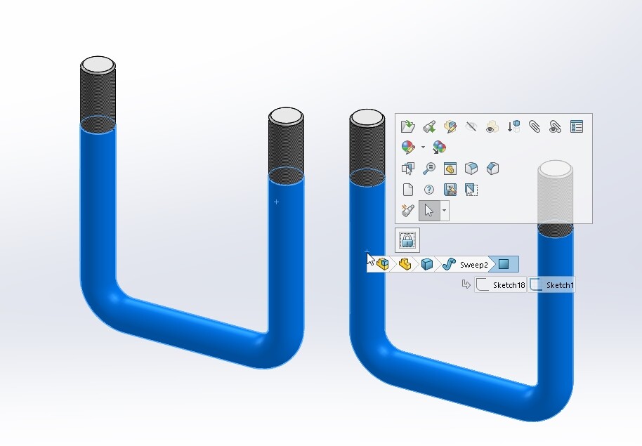

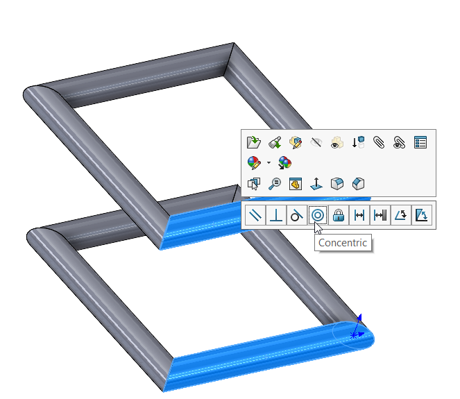

The only drawback to using Merge Tangent Faces is the fact that when using a circular profile, it will not recognize the outside face as cylindrical and therefore does not allow concentric mates. At least, that’s what happens to me because I haven’t been able to strike fear into Solidworks like matt can. :laughing:

The reason it doesn’t work is pretty simple; it’s because the entire outer face is now one entity instead of five in this case. I’m not saying there’s something wrong with the software, just pointing out a limitation with Merge Tangent Faces.
