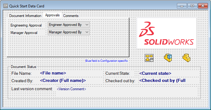

The data card would have to support what you’re looking for in terms of whether the assigned person/group has completed their approval task since there are a lot of ways to go about it. For example, if QA submits their approval then you could set the individual’s name/approval date on the data card and check to see if any approvals remain.
If you have a data card example and a flow chart of your approval process (not necessarily the workflow flow chart) then we may be able to provide more helpful advice.
We are not yet set on our data cards and are willing to change there.

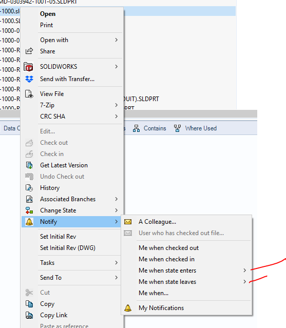

Lump it into one single group and use PDM notifications. I have even less experience with this so you might want to ask around or contact your VAR. I know that individuals can set themselves up to be notified when a document enters or exits a certain state but I’ve not found a way to set this up so that someone can set an automatic notification to someone else if the state changes. I was looking into this for a different reason, to notify CNC programmers of state change, and did not find a great answer.
Ideally the set up would be “Notify these people/Group if the state of this files enters [STATE]” So you change it to “Product design review” and 10 people get an E-mail that the state of that part has changed. Then the person responsible for the review knows they need to review it.

However, I have created ‘assigned to’ variables on cards that can be updated for this purpose.
Yeah, I was thinking the same thing…something like:
Then add a Conditional Notification to the transition that sends it to approval and add the user assignment variable to send it to the name in the variable.

I don’t know if it’s an added feature in 2021 or one of the older releases, but when I was demoing 2021 there was an option to “remind” the notified parties after a number of days until they do their approval task.
Yeah, that’s the Delayed in state" notification. Not sure when it was added but it was in 2017. The problem with it is you can only pick a specific user or group to send it to. There is no way to send it just a person assigned to a variable like you can with Conditional Notifications.
Can only select a group or a user.
