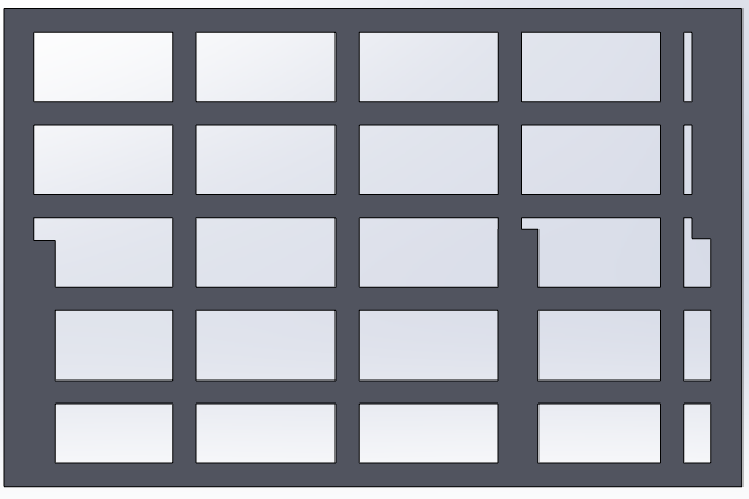

This is what the cutouts look like:

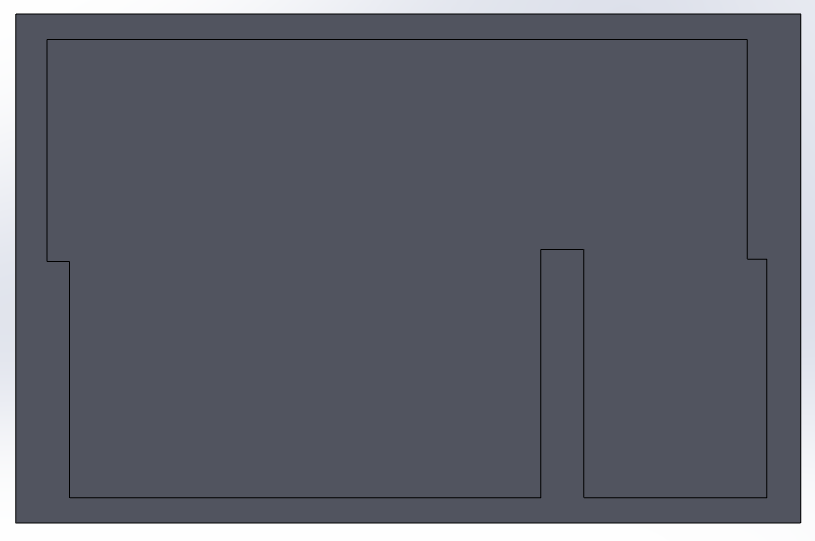

So the basic pattern is a 4x5 pattern of a cutout. Looks like a classic candidate for a variable pattern, but - the MOST important measurement though is the distance BETWEEN the cutouts (yellow) & the distance to the EDGES of the part (pink is off limits for any cutout):
Note: This is NOT symmetrical! The line in ‘the middle’ is a little bit offset.

does the rectangle that’s not in phantom lines count as a cutout?
Just thinking out loud here, why not have a variable that defines the pink cutout so that you can then work your phantom line cutout patterns inside that defined area, then you could most likely use variable patterns, though I’ve never used them. I’m just wondering how you’re going to define the yellow spots because the phantom line cutouts differ and because of this, the yellow spacing also differs. Though, if the pattern is always a 4 x 5 pattern, then that makes it more simple, just have to think of the required “equation”
Edit: Also depends of how variable a variable pattern can be, because you have different shapes all over the X and Y pattern

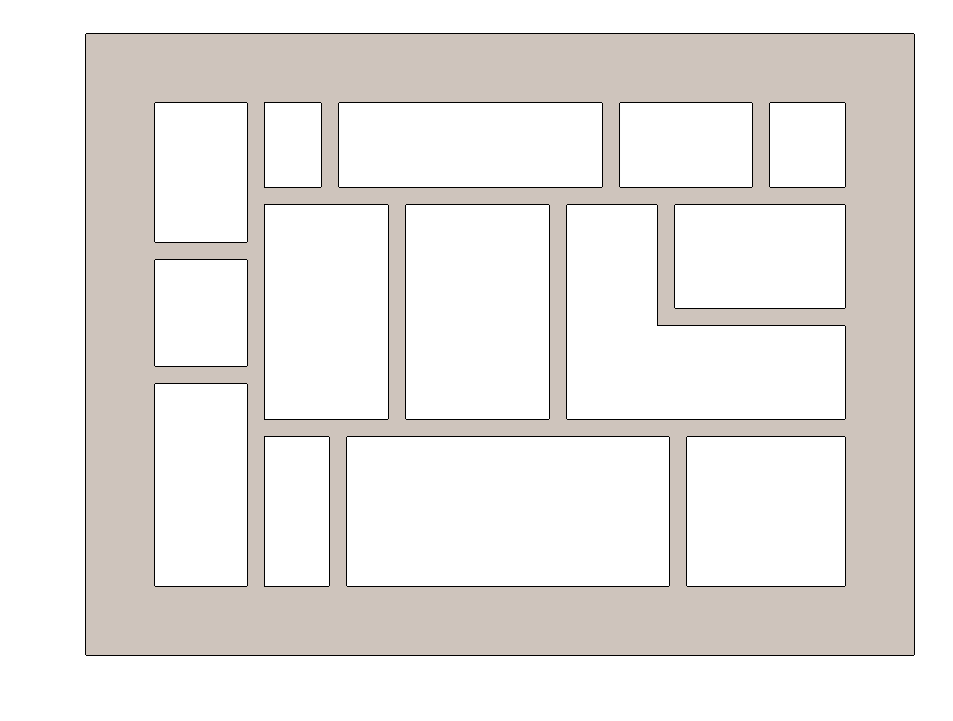

Would it be easier to “add the ribs” to a much larger cutout, rather than add the cutouts to a solid piece?
Here is a simplified example of what I mean.

It is a cutout. But that cutout has a different design intent than the weight savings & that is why I excluded it.

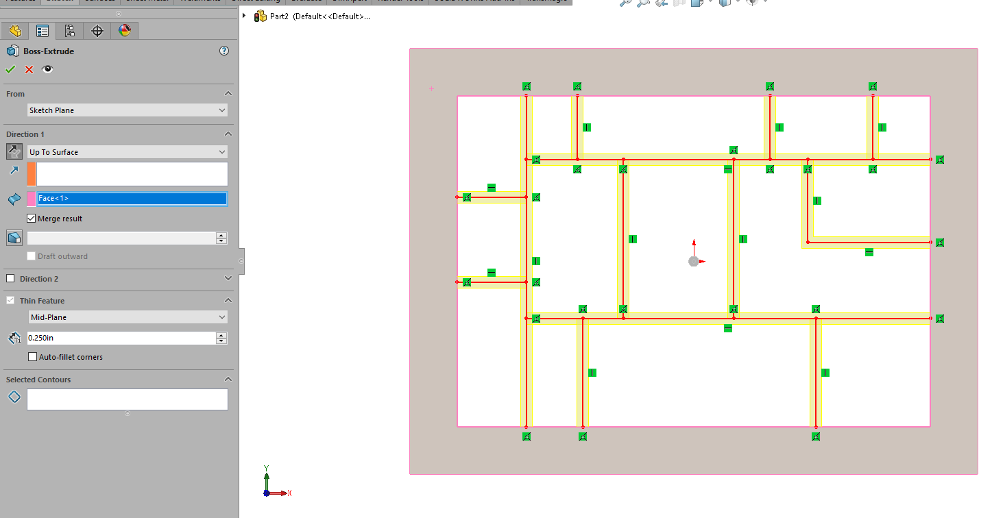

If the general goal is just to decrease weight, one idea that comes to mind is to split your part so that the off limits areas are a separate body:
Then create a sketch with a pattern in it that you can tweak:
Then use the sketch to cut only the body that isn’t off limits:
Finally combine the bodies back together:
