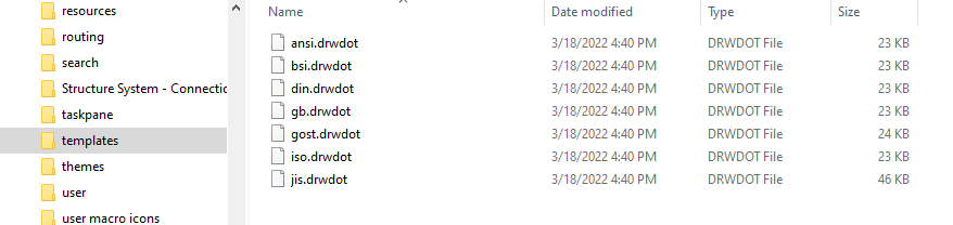

I find drawing templates in an entirely different place - Program Files/SOLIDWORKS Corp/SOLIDWORKS/data/templates. I guess I pick our drafting standard.

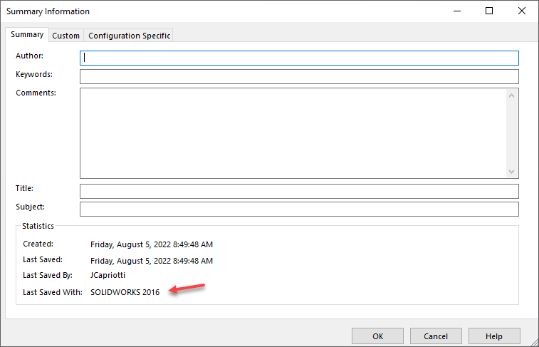

Open the template and go to "File / Properties… On the “Summary” tab there is a “Last Saved With” entry.

The Summary tab shows what the last save was, not the original file creation date, which is the “issue” here.
