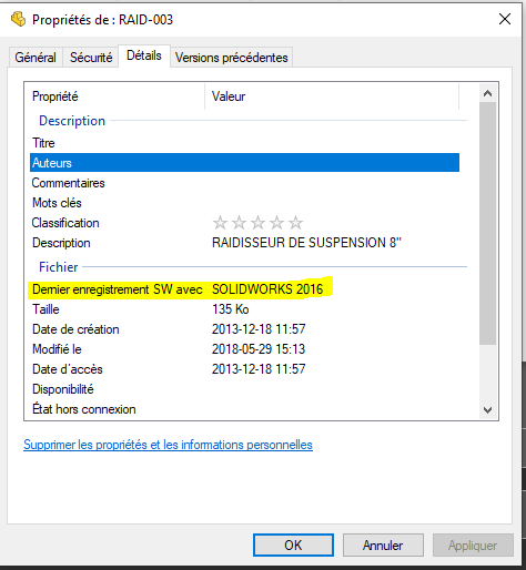

In File Explorer you can turn on a column that shows the last version a file was saved in. That being said when you want to open a file you will know what version it is in.

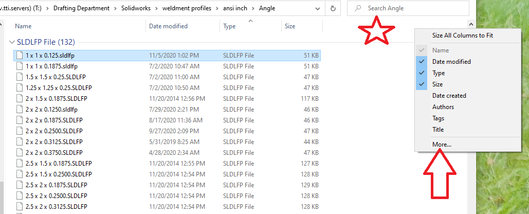

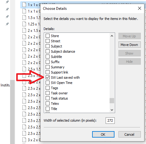

Right-click on the column name space in File Explorer and choose “More” from the drop-down.

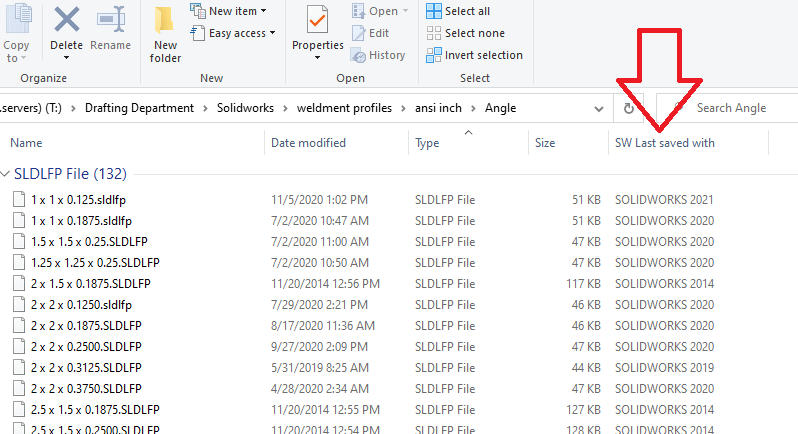

Choose “SW last saved with”, and click Okay.

Oddly enough, I always have trouble with the SW Last saved with

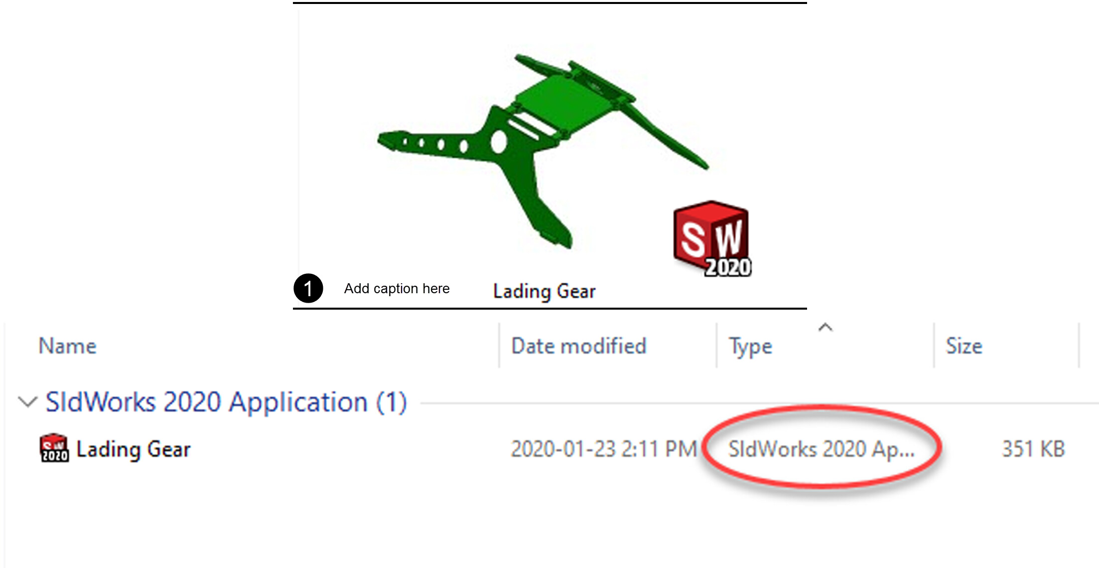

Hello Maha, what you show in the screenshot is what you are opening it with, not what version the file actually belongs to. You can use the solutions others have provided to see which version a file is saved on.
The menu is from file explorer, not the solidwork file
Try rightclicking on the column header in file explorer
Use the real interface, less glitchy(The property window)
It does, in Detail View
I didn’t say right-click on the file name. I said “. . . on the column name space in File Explorer”. Right-click where you see the red star in the screenshot below and in my original reply.

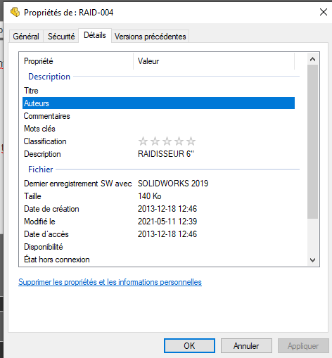

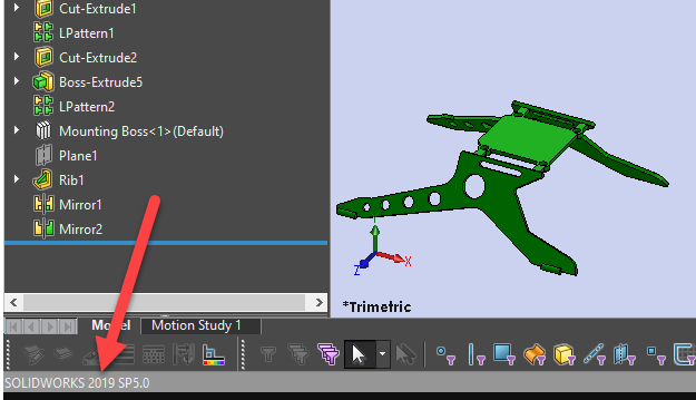

This was last saved in 2019sp5…but doesn’t show anything when I display the column.
I don’t know why but sometimes the panel doesn’t display the right things, as if it hadn’t updated or something.
File versions are not service pack bound, so you will only have the year displayed, like this, though it’s rather odd for you that it’s displaying nothing at all. Maybe it has to do with the “default program” for the file type?
