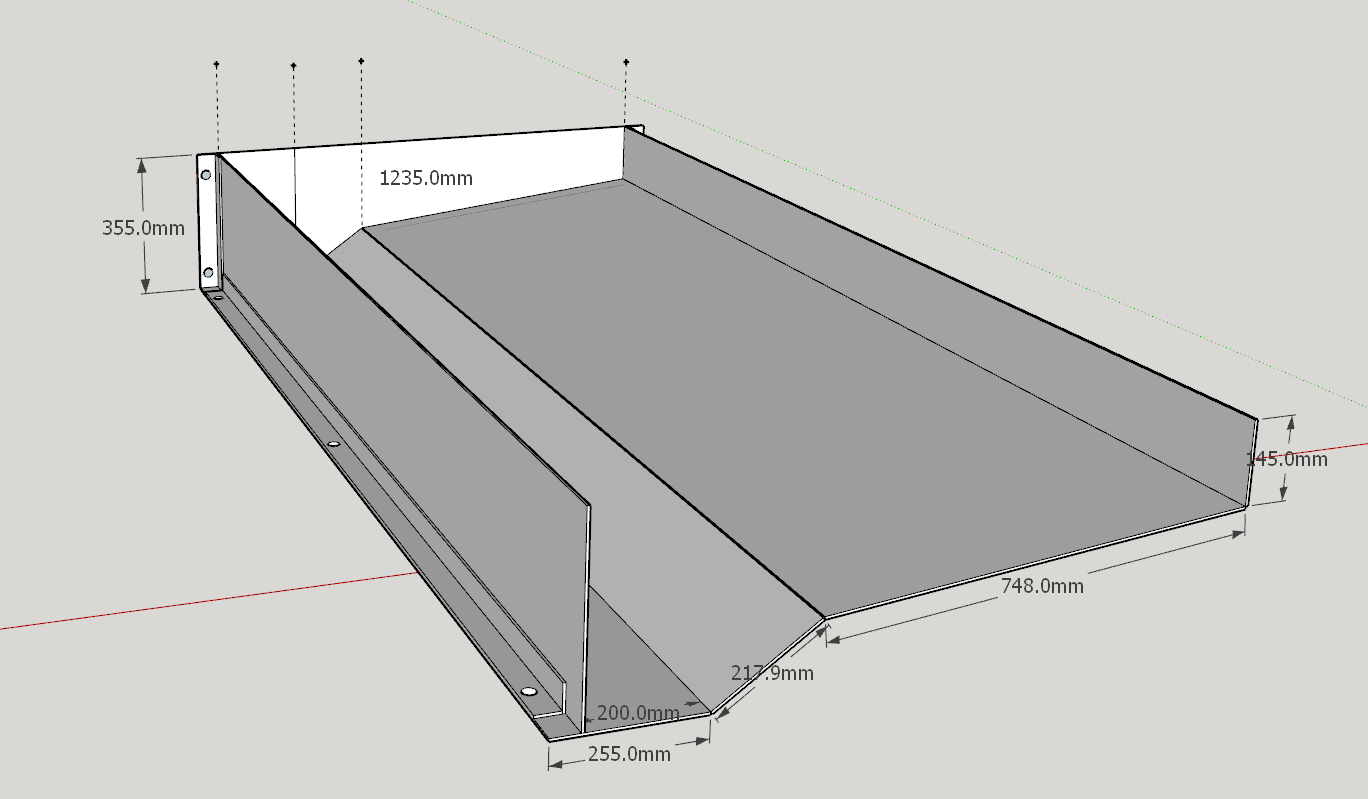

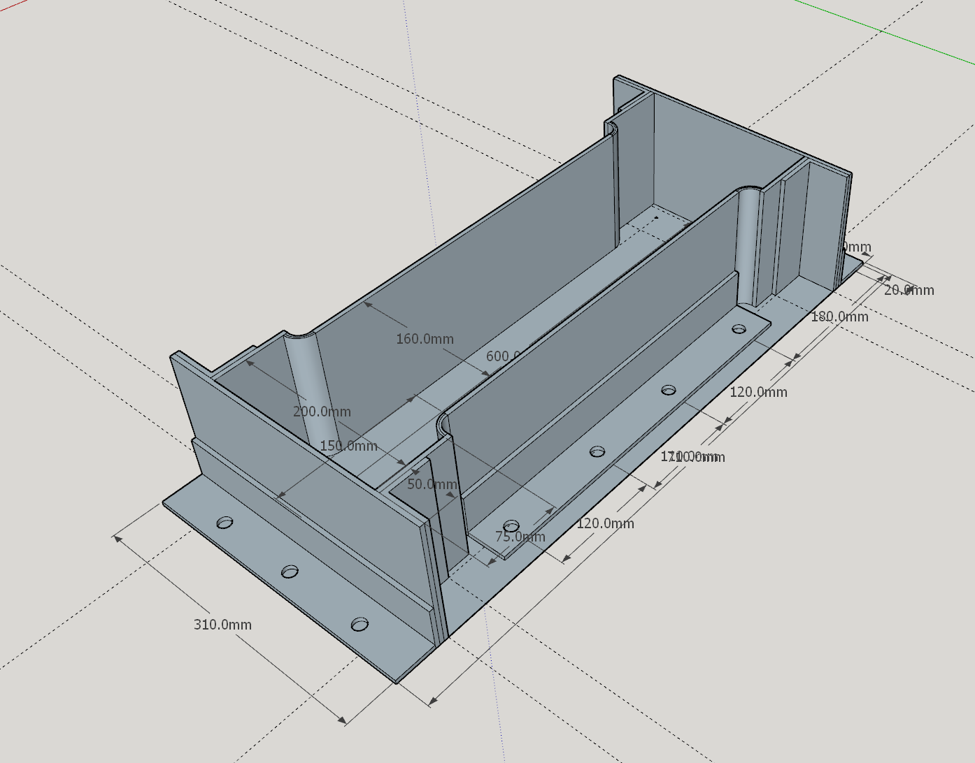

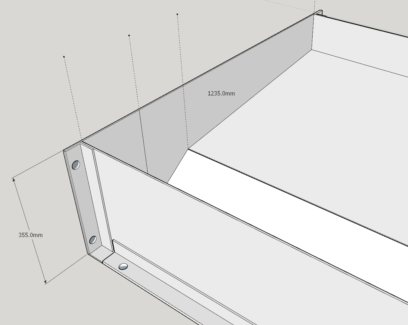

I hope someone can get me pointed in the right direction. I have spent 2 days on the youtube videos and other training material to replicate what I am doing in sketchup and QCAD at the moment. I can do machine drawing etc etc however I am unable to draw the things I normally draw when using my CCN Plasma.
I usually draw flat parts, cut them on the cnc from 5mm steel sheet, and then weld \ bolt these together. This is almost sheetmetal work but I cant bend the sheet so every bend is a welding joint for me.
So the challengis that I always draw the model twice, once in 3d and then every side\part in qcad to be able to cut on the CNC machine.
Is there anybody that would be willing to just help me get started, what would work best, sheetmetal drawing or a normal part\assembly drawing.
These are typically the models I draw, and the material I use is normally 5mm sheet metal, some angle iron, channel iron and round bar.

I am not certain of what you are asking for assistance with. From your comments and photos, I can only discern that you’re looking to redesign your work to make them more cost-effective to include sheet metal bending, but you’ve also mentioned that you don’t have access to any sheet metal bending processes.
If you’d be able to add sheet metal bending to your designs you definitely save time and money by eliminating a good amount of welding (seam, plug…) and the grinding and the buffing that goes along with it. Also, bending would most probably increase the structural integrity of your components.

Thanks for the reply, what I am trying to do is to draw these sketches in solid edge, at the moment I am unable to draw them in solid edge, yes total noob, I have drawn these in sketchup, but then I have to go and draw these again in 2D to cut on the plasma cutter, that is where I want to save some time.
I am looking for some guidance on where to start, should I use sheetmetal or just iso part to draw these. basically I would like to understand how someone whould draw these types of sketches in solidedge.
