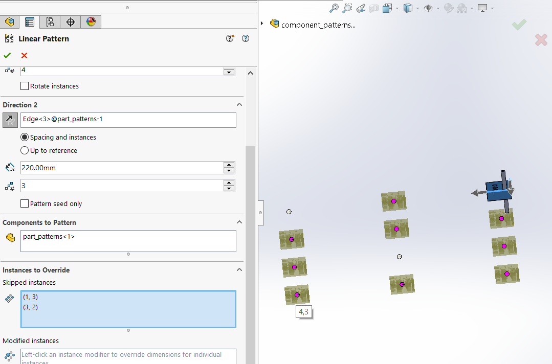

The property SkippedItemArray, which most component patterns have, suggests that internally each pattern component is referenced by coordinates (one or two):
As far as I can tell, the same coordinates always give the same position, no matter what the pattern component’s GetID() is. So these coordinates would be the perfect reference for a pattern component. But: I could not find any API method that gives me a pattern component for given coordinates.
