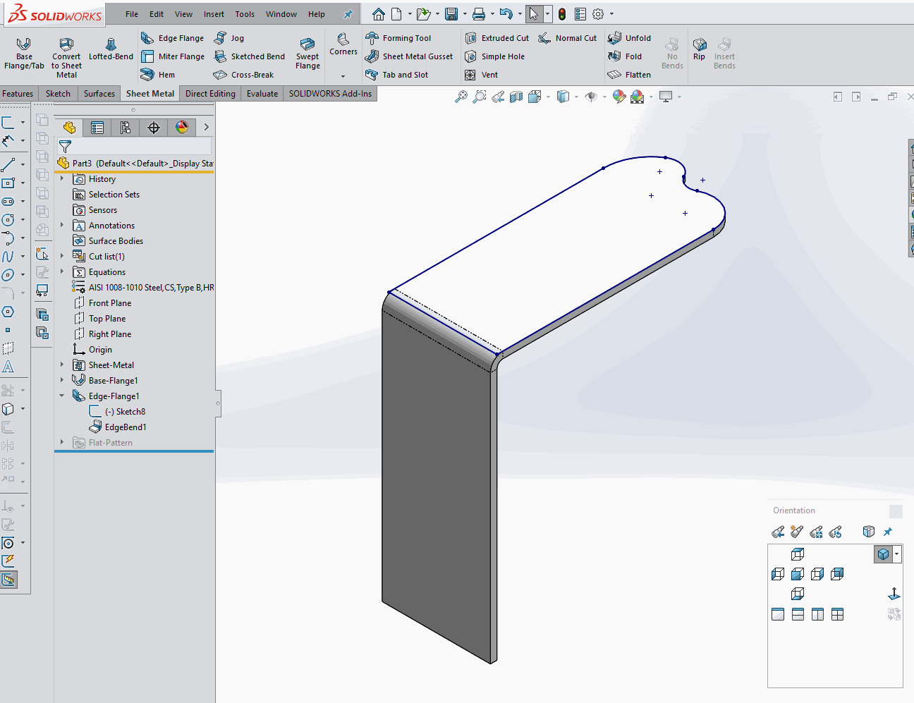

I used to modify the flange profile in Solid Edge. Fairly often. It seldom gave me problems. I did same thing in solidworks then went back and edited the base tab and the flange feature needed the edge redefined. Redefined the edge and bam, the flange profile is back to default and the sketch I had is gone! WTH SW!?!? <()>
Is this what others have experienced? Is the solution to never edit the flange profile? That means extra tab and normal cut features.

edit, added gif of a simplified process. Typically, there’s more involved in the tab sketch that causes the flange to fail. But it shouldn’t regen the flange from scratch, just update the edge it’s on.
bnemec I see now, it resets the flange when reselect the edge. Same thing happens if you simply edit the edge flange and unselect the edge, then reselect it. I’ve never done that before, or if I did, it wasn’t a custom flange shape.

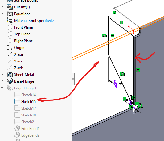

Your video looks does not look right. When I edit a flange sketch, the 3D bend shape disappears and the picture returns to the original edge (see image).
I can edit this sketch as often and as radically as I want. Do not, however, replace or move the line in the sketch that represents the edge you selected to make the flange. You can move the ends of that line, but not the line itself.

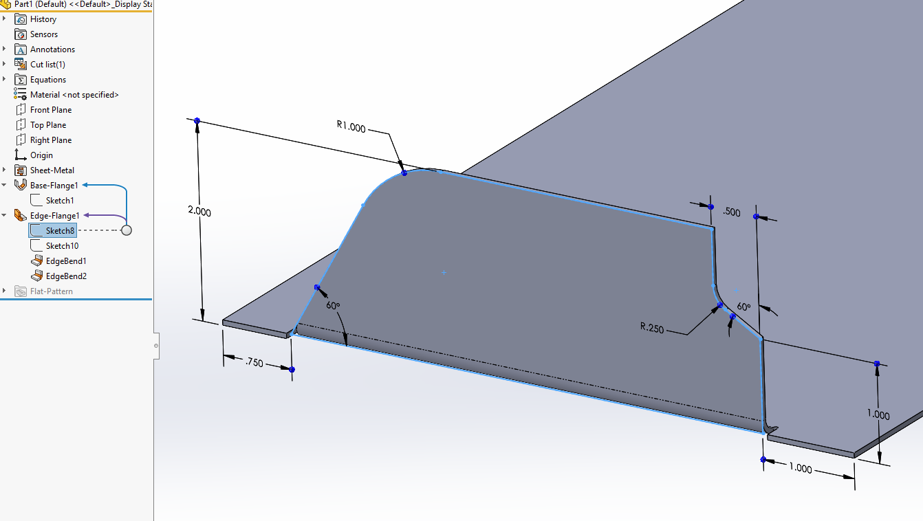

Here’s a gif of SE custom flange sketch at various flange angles, the flange matches the sketch. I didn’t bother constraining the sketch, maybe I should have but the point is the flange matches the sketch. In SW the flange only matches the sketch if the flange angle is 90 deg. Or am I missing a setting somewhere?
It only affects modified flanges sketches that are not 90°.
Normal flanges have this option to control flange length. Normally for a non-90° flange it would be tangent to the bend (3rd option.
The problem is when you modify the flange sketch, you lose the option to control flange length. Instead you have to define it in the sketch and you can’t easily get the bend tangent point because it doesn’t yet exist when modifying the sketch.
So for a normal flange, SW is disregarding the sketch length and adjusting flange length based on flange position option selected. You only notice it on non-90° bends. The modified flange on the right I made 2.000 in the sketch but really I want the bend tangent point. Even in SE I didn’t see how to get that dimension, although it seems to handle the sketch offset better.
