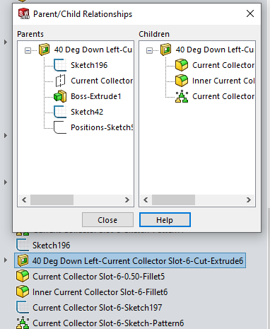

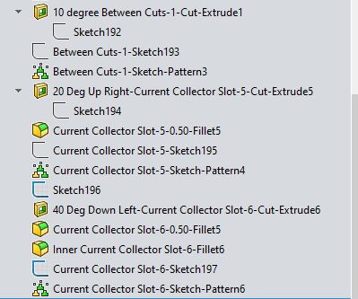

I have an Extrude Cut Feature that the sketch somehow let me drag the sketch out from under it like you would normally see, how do I get it back under the feature it created?
as you can see the 40 degree cut extrude has nothing under it when I try to expand the tree (should have Sketch196)
in the past I have seen this happen and no idea on how to correct it or make it like you would normally see other than delete the feature and redo

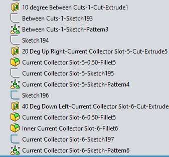

You probably pressed Ctrl+T and activated Flat Tree Display. Press it again and it will include consumed features under the children.
Hi again,
Tried the Control T and it puts all the features and sketches apart but when I toggle it back nothing changes
CTRL T:
CRTL T again
seems to be only on that one feature, was fine after I created it and had a pattern I was trying to drag up in a folder and all of a sudden noticed this

I have tried to replicate this, but only could let it be unabsorbed using the freeze bar.
Maybe it is due to the parent relation in the feature or maybe a bug? I didn’t find a way to unabsorb one specific sketch :confused:
