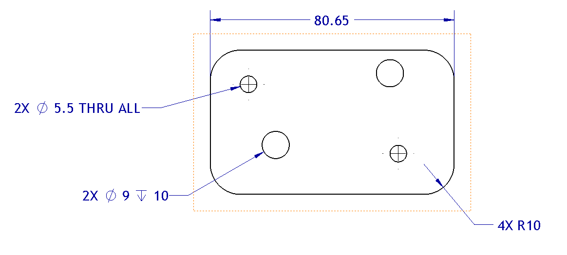

  1. Export the number of instance, even if it is added by user (for the image below, 4X)
  2. Export the full information of hole callout (2X and end condition information)
    Appreciate if anyone could point me to a feasible method/command
IDisplayDimension::GetText Method should help get you there. Take a look at swDimensionTextPrefix/swDimensionTextSuffix.
