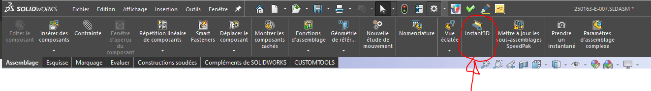

I did some research into instant 3d, and do not see anything I typically use. I went to turn it off, but it appears to only be available through the command manager, and I must have deleted that button.

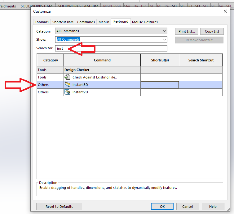

You might be able to turn it off and on with a keyboard shortcut. I haven’t tried it, but it looks like it would work.
Warning, frenchness ahead
I’ve customized the UI quite a bit, so I’ve made that button go away at some point.
