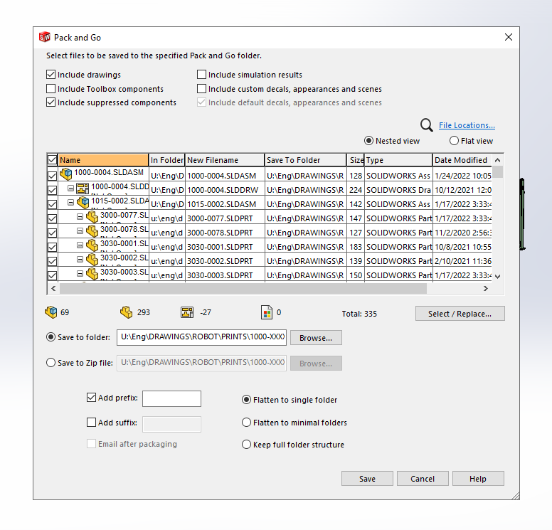

When I do a pack and go in Solidworks 2021 SP5 I want to include the drawings. It only gives me the top level assembly drawing and does not give me any other drawings of models included. It also shows a -27 next to the drawings icon. See picture attached

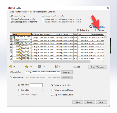

A weird bug. Switch to Flat View before checking “Include Drawings”.
Unfortunately, I was also seeing this issue. And switching to Flat View does not fix the issue for me. I am using SW 2021 SP5.1.
However, I actually found something useful on the other site (SWYM), if you click on the File Locations option and check the box to “Include subfolders” the drawings will show up in the list again.
This post is gold. I solved the same problem switching to Flat view.
