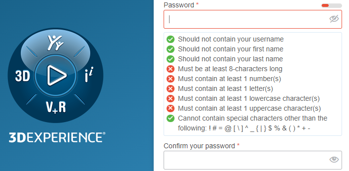

I was trying to create a new 3DX account today (gosh why am i doing this…) and wondering why i could not get through
Apparently 3DX only allow specific symbol for their password and the password that i tried to use contained “/” which is prohibited.
HOWEVER
My other account which is created long ago contained “/” and has no issue login… (well.. most of the time)
So, the artist formerly known as Prince would be good to go.
