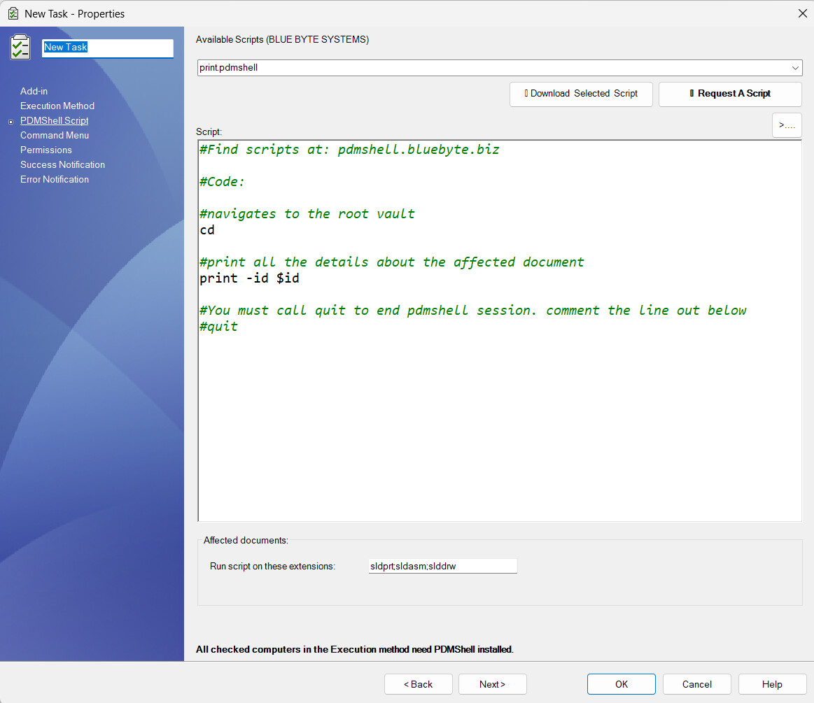

Our tool PDMShell aims to replace Dispatch. It’s free to try.
We also created a task for it TaskScript, take a look:
