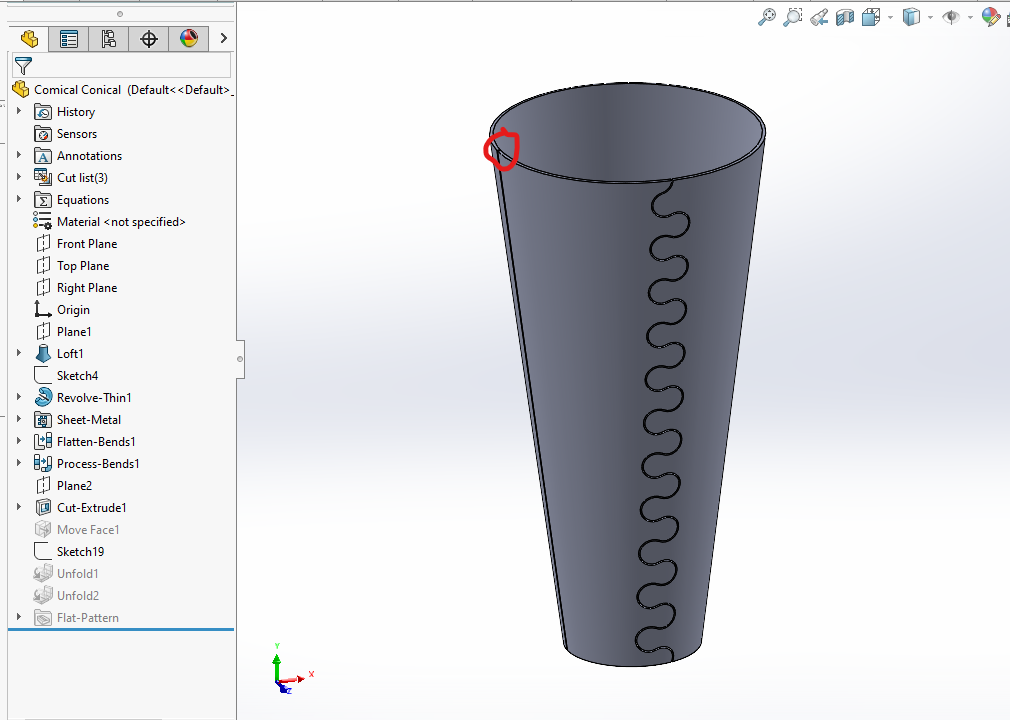

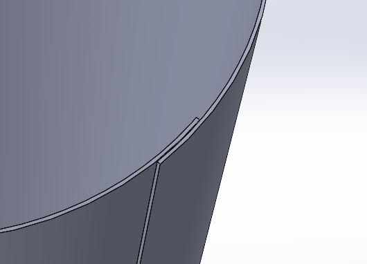

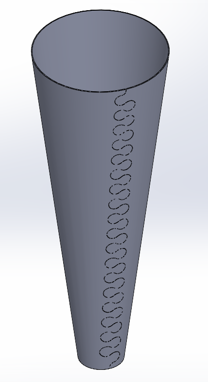

Hi, I need to design a Sheet metal cone that has a puzzle-like joint at the seam (this will actually be a plywood part with relief cuts to make it possible to bend it into a cone, and glued at the puzzle joint):
To further work on this part, I need to convert it into Sheet Metal, but I can’t seem to make that happen. Neither Convert To Sheet Metal nor Insert Bends seem to work, they don’t accept edges or faces at the puzzle seam. Do I need to use a different modeling strategy here? Anything works, but the final geometry must be like this. Download the part: https://ufile.io/whx0huo6 Any advice?

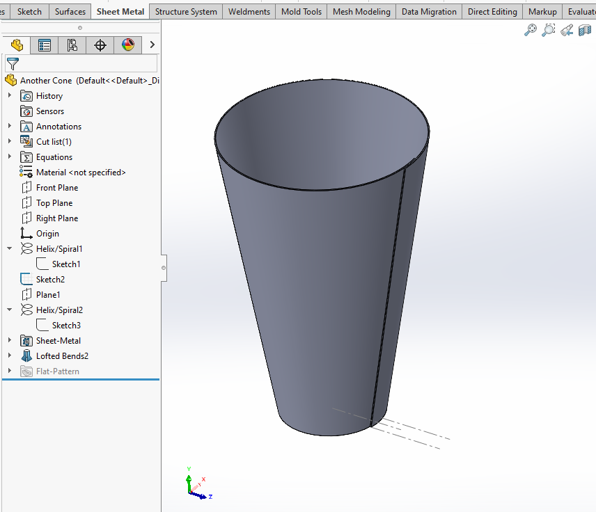

I did not use your file but I suppose you could do this with a lofted bend or a converted “Revolve-Thin” (like I did). This would give you two sheet metal bodies that would flatten individually, or you could unfold both of them and fill in the gap if you like. If you made a couple of configurations you probably could make this work and look like you would like it in the folded and unfolded model. If I remember correctly SW does not like the ends of a cylinder (or Conic) intruding into each other (in one piece). You also could overlap this (I’m guessing) with a joggle or as a spiral and make it work in one piece. Just wouldn’t look like you would like to see it.

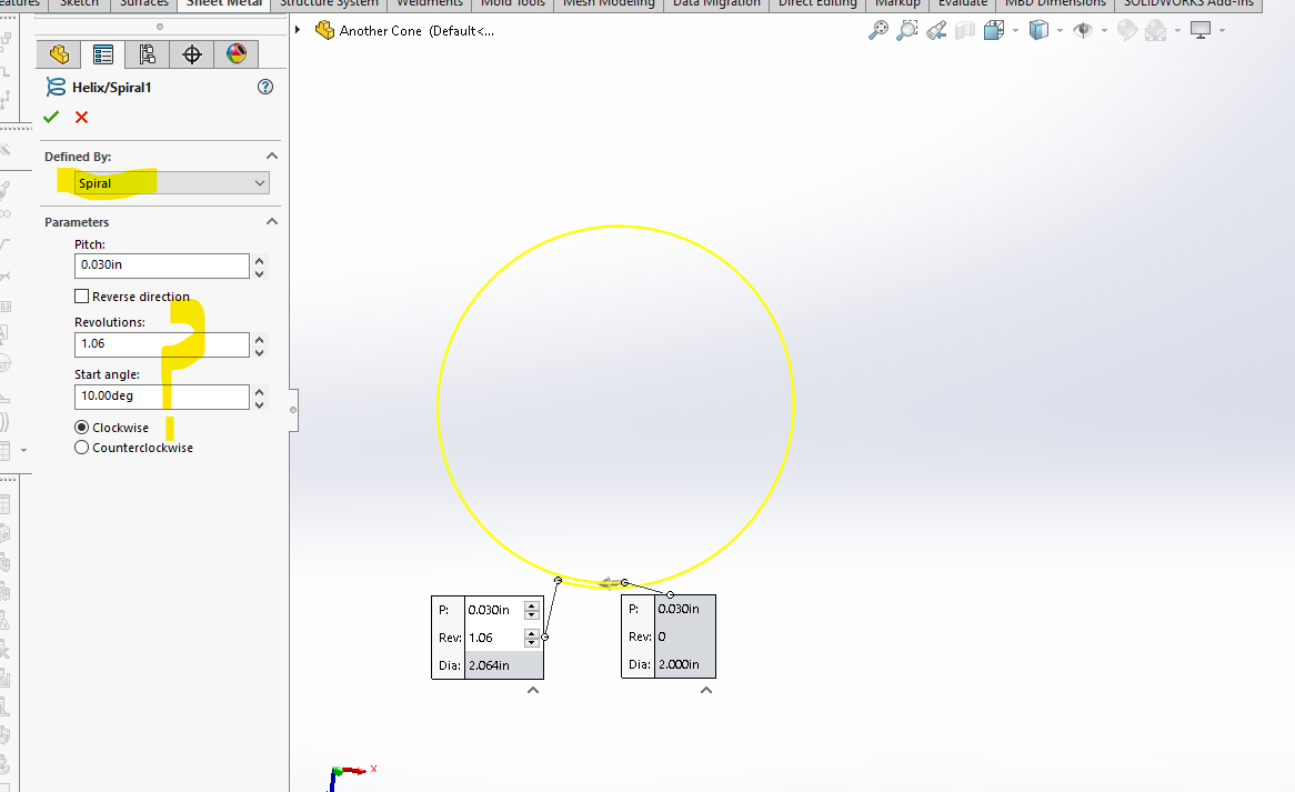

Sounds like you have a good understanding of this Laukejas.. The second overlap idea is this. Two spirals (top and bottom). The spirals overlap by an amount something over what you need to cut the part with your puzzle cutter. I suspect when you do that you will have a bunch of bodies you will not need. You need only select to keep the main body???.
Edit:.. Hmmmm, I may have to put some more thought into this. It is not working out as I had hoped.
That is an interesting idea, but then the part would not be circular in the model (it would be spiraled). That would prevent creating additional features and connections with other part (for example, the upper edge must connect to another part that is also cone shaped)…

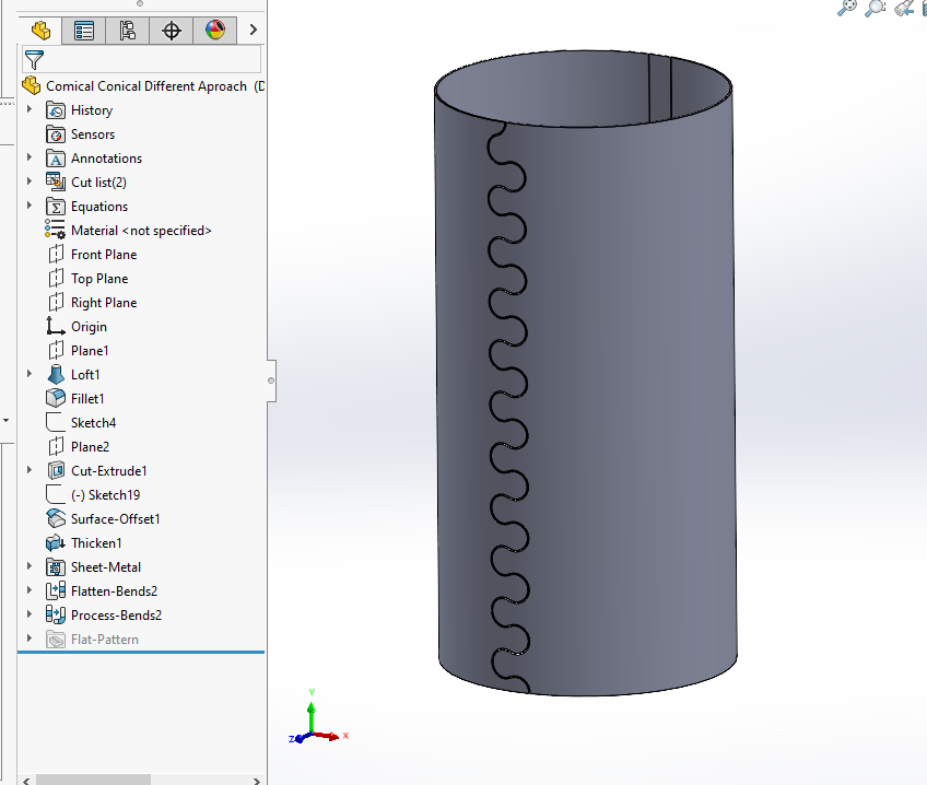

I figured that might be an issue.. This thing is driving me crazy.. One thing I did discover is contrary to what I had mentioned earlier. So far I have only got this to work on a cylinder. If I taper (make a cone of it) it no longer works. I think there may be a way around this, there almost always is. Maybe you can come up with something. I made a flat (could have been much smaller) at the rear of the cone and did an insert bends from the flat (planar) face. It didn’t work on a cone but it did on a cylinder. The cone is still conical with the exception of the small flat to flatten from.
That is a very creative approach! I am trying with cone now, and can’t seem to make it work either, though. Not sure what exactly is causing the failure though. Can you share your part? I can’t seem to make it work with a cylinder either, lol

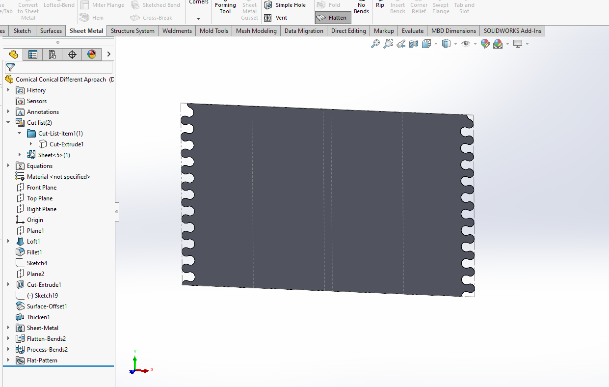

I’m trying to figure out how to upload my file to this post… Guess I should save this as a draft prior to attempting that since I keep loosing what I typed.. Major frustration. As I mentioned in my file I started out with a solid loft, cut it, filleted the two edges on the planar section, offset surfaces 0, thickened, then insert bends. When I change or alter the diameter of the bottom profile sketch of the loft, to anything other than the diameter of the top profile it does not flatten. So I suspect the issue is how the fillets and the conical portion are blended??. Accidently have two now.. I just might be getting the hang of this now.

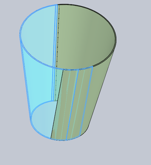

What he said with the cone but with slight modifications:

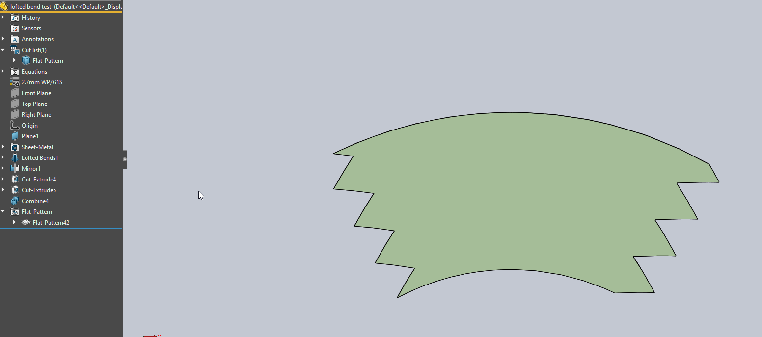

Model only half of it (overlapping), mirror the bodies before you apply the puzzle cut(!):
Make your puzzle cut on both bodies, combine, flatten (I just did a triangular cut).
Make sure to keep the bodies separate until the last step!
I left a slight distance in between the puzzle cut so I could combine the two sheet metal pieces. I also left a “flat” surface at the other side of the cone. I think you could get rid of it though or make both distances tiny.

Attached the part & another screenshot.
Please don’t judge me for the ugliness of all of this. It was a job done quick & dirty!

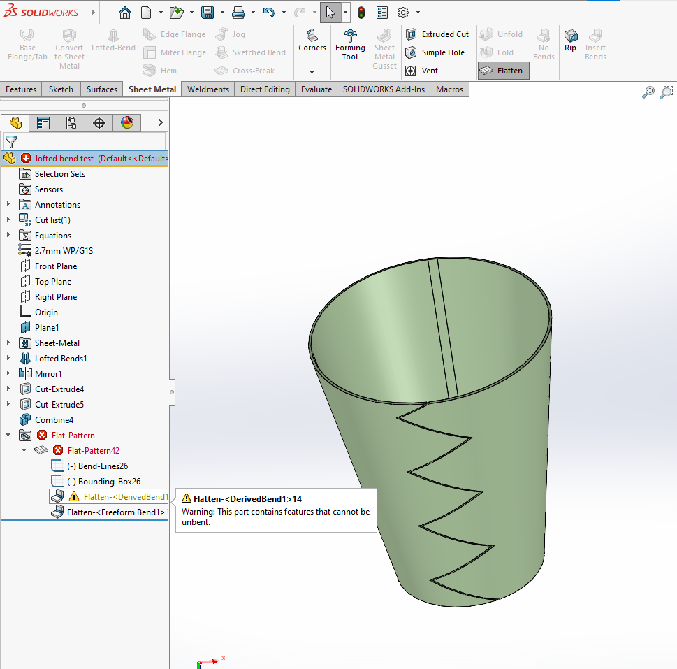

How did you get this working? When I open the file you uploaded and try to flatten, I get this:
Interesting. What version are you on?
I’m on 2021 SP4.1 and as you can see I could simply flatten it.

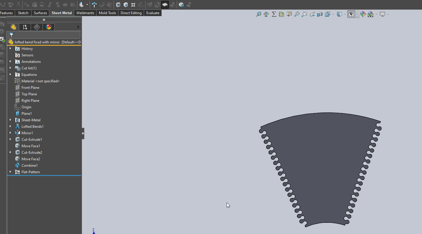

Let me know if this works for you now:
lofted bend fixed.SLDPRT (1.63 MB)
lofted bend fixed with mirror.SLDPRT

I’m really proud about the move face feature in this one! ><

Amazing stuff, man. Not sure how you fixed it, but lofted bend fixed with mirror.SLDPRT is exactly what I needed. Really smart thinking there. Thanks a lot! This does everything I ever hoped for. The project may now continue! :smiley:
