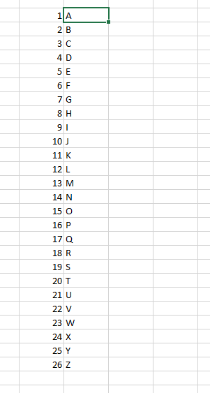

=MID(“ABCDEFGHIJKLMNOPQRSTUVWXYZ”,B18,1)

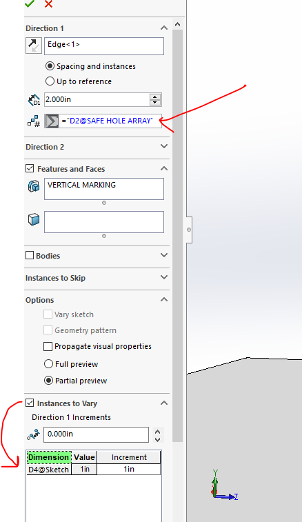

The numbers are done by a nifty thing I found in the old forum. In your sketch you draw the line for the text and another line. You dimension that line and make it the length of the amount you want the increment to be. So 1,2,3,4 you would draw a 1 inch line. For .5,1,1.5 you would draw a .5 inch line. Make your cut. Then when you array the sketch you link the “Instance Vary” option in the array to the dimension dimensioning the line. I then tied the number to array to the number in the actual hole pattern. So now I can enter the hole pattern and the marking text automagically creates the right amount of markings and the right sequence.

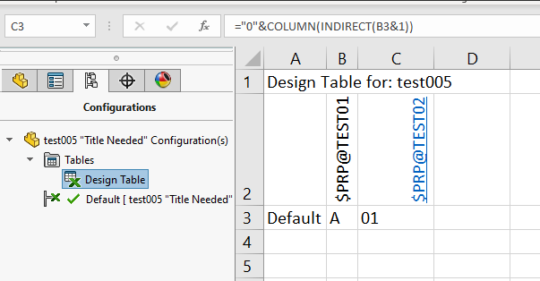

Sorry for reviving this age long thread… just stumble across this while i am trying to figure out how to convert A to 01 in Solidworks without involving macro or drivework..
Interestingly, using a design table seems to work…
Basically the design table is just to use excel equation as the equation capability in solidworks is really limited
(To convert number to letter, you will be using char() instead)
However, the design table need to be updated everytime the number/letter change…
Custom property
Design table
