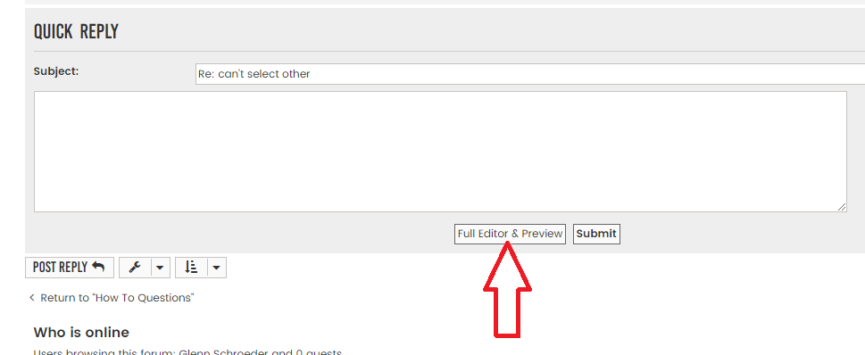

Click on the “Full Editor & Preview” button. Then you’ll be able to attach files and screenshots.

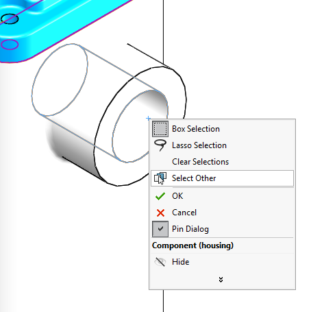

Now i’m on my home computer, pasting an image from my clipboard.
Edit: it works. I’ll think about asking IT to whitelist me for this “social media” site.
Try RMB while cursor is on some face/edge/vertex
