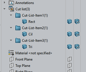

Have you tried making a Cut-List by going to the Weldments tab and then clicking on the Weldment command.
You can then add properties to the cut list item, a partname for example.
Which then can be linked to the drawing notes.
I believe there are some macro out there that can copy the body name to the cut-list-item propperties.

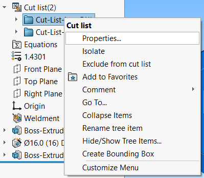

We are getting somewhere because there is a way with cut-list to get there (it didn’t work for my colleague but it does on my identical computer with identical software and identical version of Solidworks)./
Now it would be great help if we could get the cut-list folder name to, by means of a macro, take the name of the body it contains. I know it can’t be the exact same name but even if there was just a space added before or after the name of the body it should work.

The code below will put the bodies in a cut-list and add a custom property with the name of the body. Which you can link to a drawing note. And it also change the name of the cutlist folder to the name off the body with an extra space at the end. Let me know how it goes.
