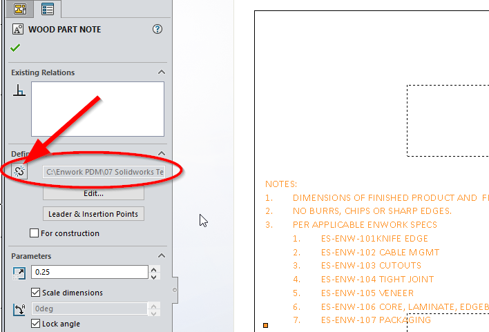

Additionally when I create blocks in the template it does not allow the “link to file” that you normally get when inserting a block into a drawing.
Anyone else have this and know of a solution?
EDIT
Once placed in the drawing (from the template) it DOES allow me to reestablish the link but it is NOT set by default.
