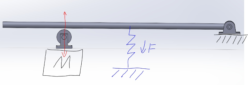

Posting this ASM based on a question over at the Swamp.
Tangency mate has a tendency to flip if you use just the geometry. For something like this using a sketched line along the bottom of the rod and mating that tangent to the roller will solve the problem here…If I read the question correctly. See attached ASM.

The problem is that toroidal surface on the roller. Can’t really mate to it. We have a similar thing on our door rollers that travel on a rail.
Created a circular centerline sketch on the roller surface for mating. Then mated it tangent to the center plane on the rod.
Tried creating another sketch circular centerline on the toroidal surface instead of at its centerline. Then mated that tangent to the rod outer surface. Was a little worried it would flip the mate but it didn’t.
Spoke too soon…second method jumps the roller to the other side of the rod if you move it too fast. You can still simulate the motion but you can’t move it too fast.
So, I think it’ll work if you put a line on the bottom of the rod and mate that sketch to the sketch of the roller. Then it can’t jump because it’s constrained…I think…Maybe not…But, I think it would be a little more robust?

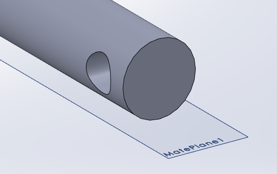

I’m not crazy about mates to lines if I can avoid it, so instead of drawing a line at the bottom I think I would create a plane there instead. Similar to the first solution but more robust I think for cases where the roller groove center is not the same dimension as the rod.

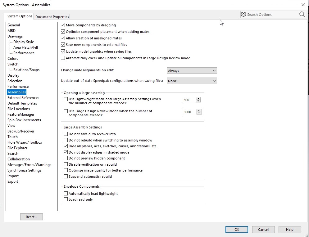

mike miller Do you not get this? I always select No and don’t ask again, unfortunately only good for the session.
Make sure this isn’t unchecked. They should make it a drop list (Prompt, Change alignment, Don’t change alignment)
Nope, I don’t. Must be I’ve posted too many snarky remarks about DSS. Actually, yes. Once I found the dropdown halfway down the page and set it to prompt…
(2021 SP1, BTW)
