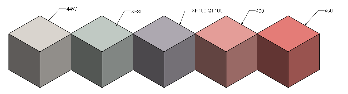

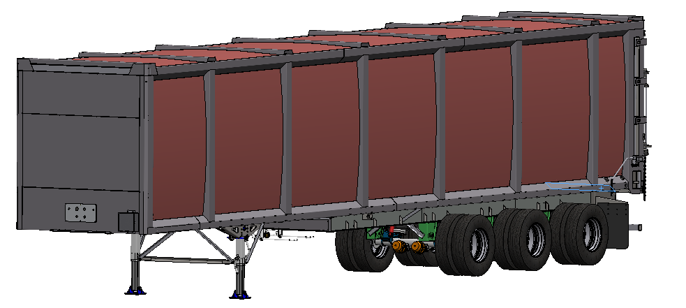

Edit: For instance, we use appearances for materials as I spoke above, to differentiate different types of steels and aluminium and what not. So the appearance is always applied to the body, and follows through everywhere, unless someone overrides it with whatever appearances he desires, or SolidWorks acts up like it sometimes does
So when we overlook a trailer from the model, it’s easy to know if something has the wrong material

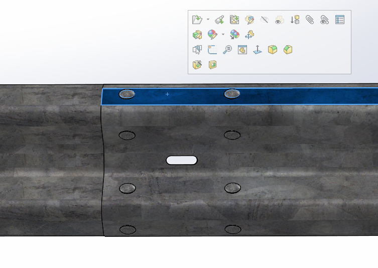

I’ve had occasional issues with appearances with the last several releases of SW and at least 2 different computers. I’ll have an appearance in a Part, but it might or might not show up. See below. These two parts have the same appearance applied at the Part level. It shows up correctly on one of them but not the other.
I can click on a face and it comes back, but only until I click away.
We’ve had that on occasion when using parts with “custom” made appearances that use an image, for instance checker plate.
