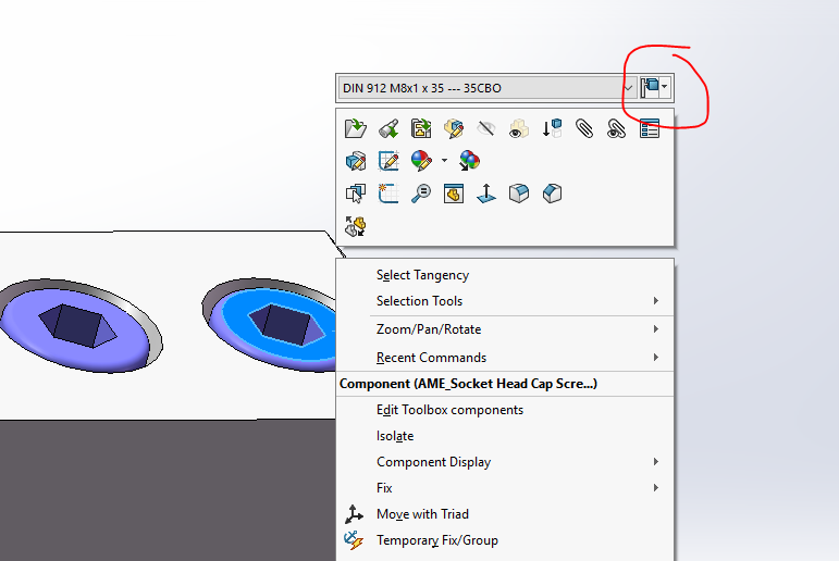

So I have run into this in multiple situations and on multiple occasions and each time the first thing I think is “Hmmm, I’m doing something wrong” then I move to “I know I did that” then “SW is completely broken again”.
So on many many occasions I have set one of the many “apply to all configurations” and had it simply not work. The latest is the one in the picture below. I have tried changing that to “All configs” and “Select configs” and neither works. It simply ignores me and says “Apply to this config” for every config that I have.
I’ve run into this in the custom properties, component properties and just about anywhere else you have the option to apply something to “This”, “All” or “specify”. Even more painful is that in some cases “All” doesn’t work but if I go in and specify and select all…well that works.

I think you are misunderstanding the command, at least in this instance. The little indicator is to select what will happen when you execute the current command to change the configuration of the part. You are selecting whether the change will be applied to the current config, all configs or selected configs. This selection applies only to the command being executed. It does not persist into the future. It is a little bit clearer when you look at the the full Component Properties dialog:

I do that with parts but in this case it was a toolbox fastener so that option isn’t available. “Edit tool Box Part” which doesn’t have a config option in it at all. so what I was doing was changing the TB part, then setting that to “All configurations” and…well, didn’t work.
I think I’m expecting it expecting it to work exactly as you described and it’s not, unless I’m also mis understanding you.
So the option is available when I change from an M12 to an M8 let’s say. If I select “All configurations” what I think it should when I check the green check mark is change that fastener from an M12 to an M8 or from anything to an M8 in all configurations.
Instead of that happening, whether I select “All” or “Selected” it changes the configuration I’m in from an M12 to an M8, but has no effect on that item in any other other configurations.
Also as I’ve said I’ve done this exact thing in other cases and the “All” does nothing but if I select “Specify configurations” and select all the configurations it changes all the configurations.
Maybe this is a bug with TB parts? I don’t use them.
Does same error reproduce when selecting non-TB parts similarly?
I’ve had the same thing happen with pretty much all parts particularly here below. That’s where I’ve had “Specify Configs” work and “All” not work.
