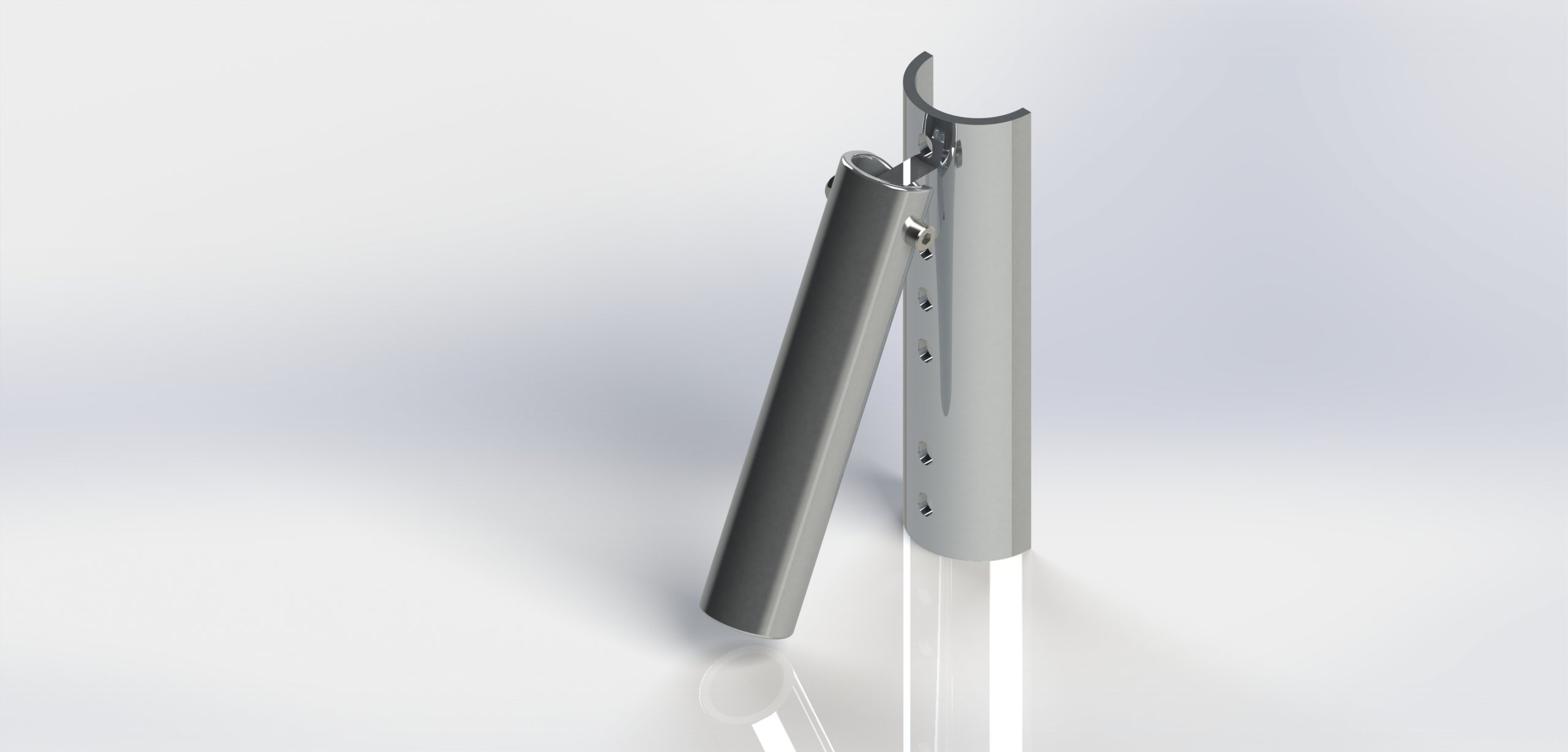

So I want to embed my part shown here into a block and do a three way split for making a mould for carbon fibre layup. I vill 3d-print the three parts and clamp them together to make a compression layup after wetting out the carbon fibre.
I have a reference plain set up in the middle of the tube/tab and in back of the half tube going perpendicular to the first plane.
So how would I go about this, using the mould tool in solidworks(that I never used before) or using the cavity command and split feature command two times?
Terje
Or just use surfaces, subtract part from a block and split with the surfaces you created. Should take a few minutes.
Yeah, don’t use the SW mold tool, just make splitting surfaces.

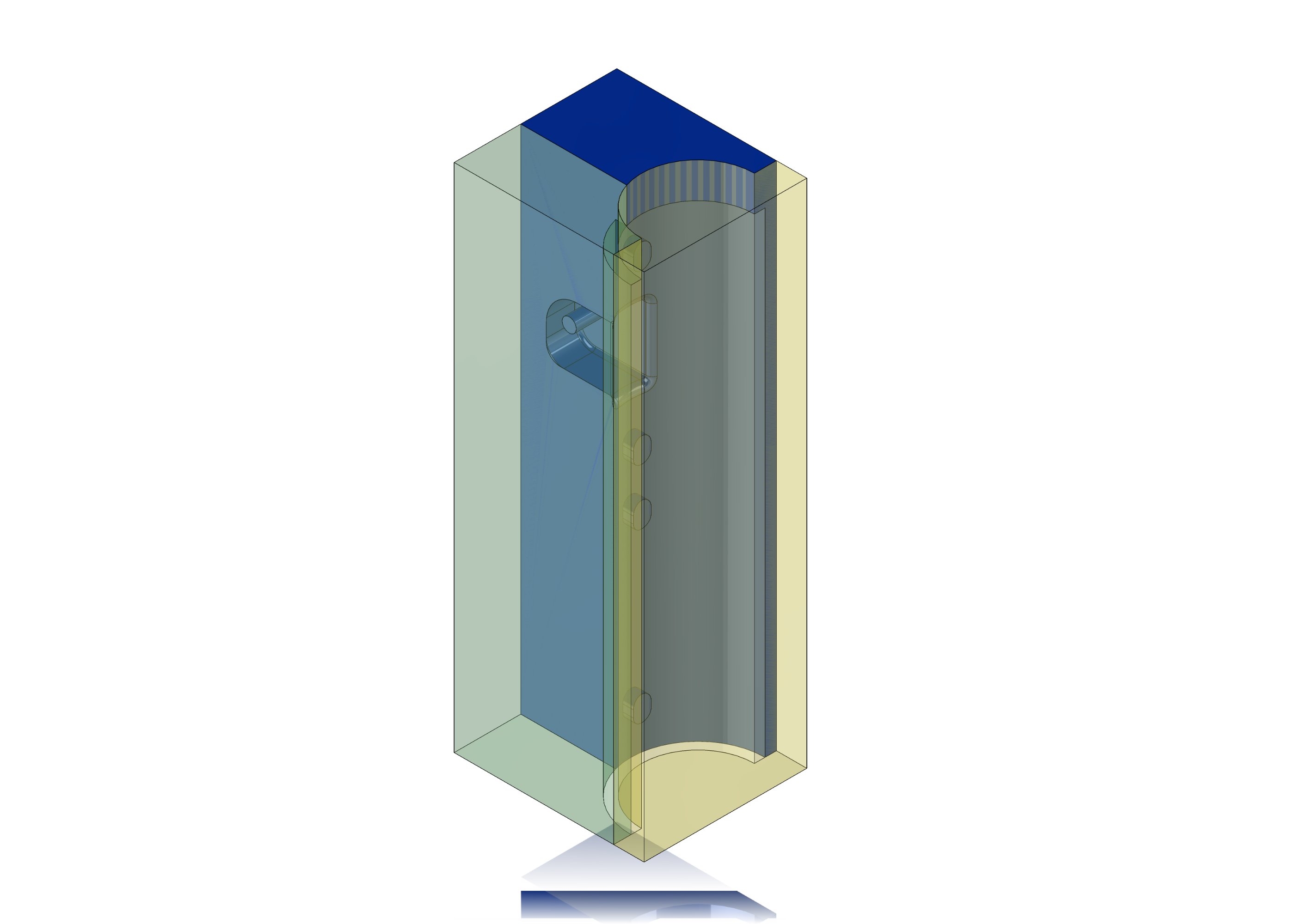

I’ve been trying out the mould feature in the meantime, I’ve kind of got it working, but I need the black part split down the middle to, parallel to the protruding tap. Maybe I can just make a plane and split it that way, or can it also be done ine the mold tool?
Terje
Now that you have the black part you could do a split part feature on that to get both halves.
And same as previous comments, the SW mold tools are a not ready for prime time feature.

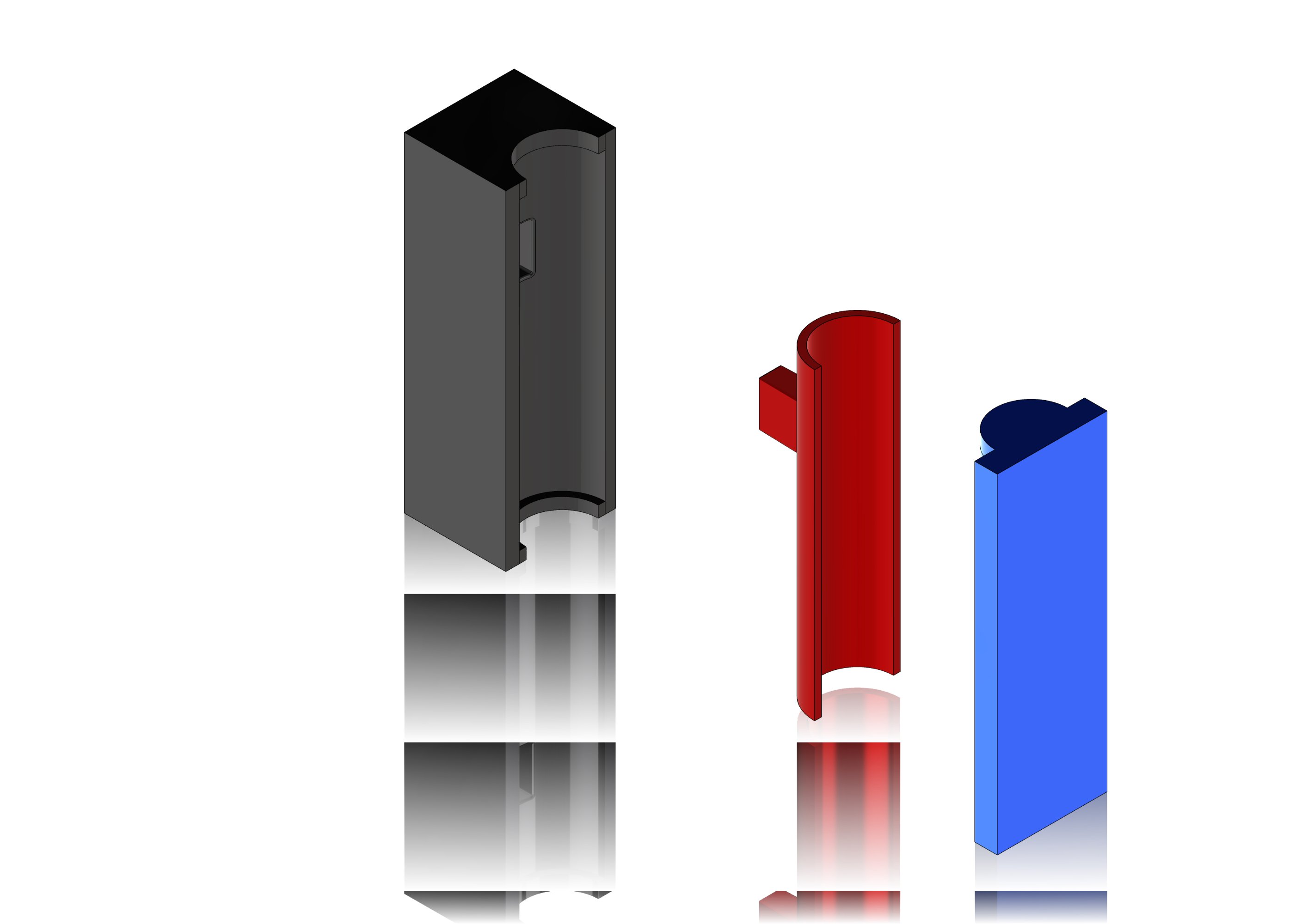

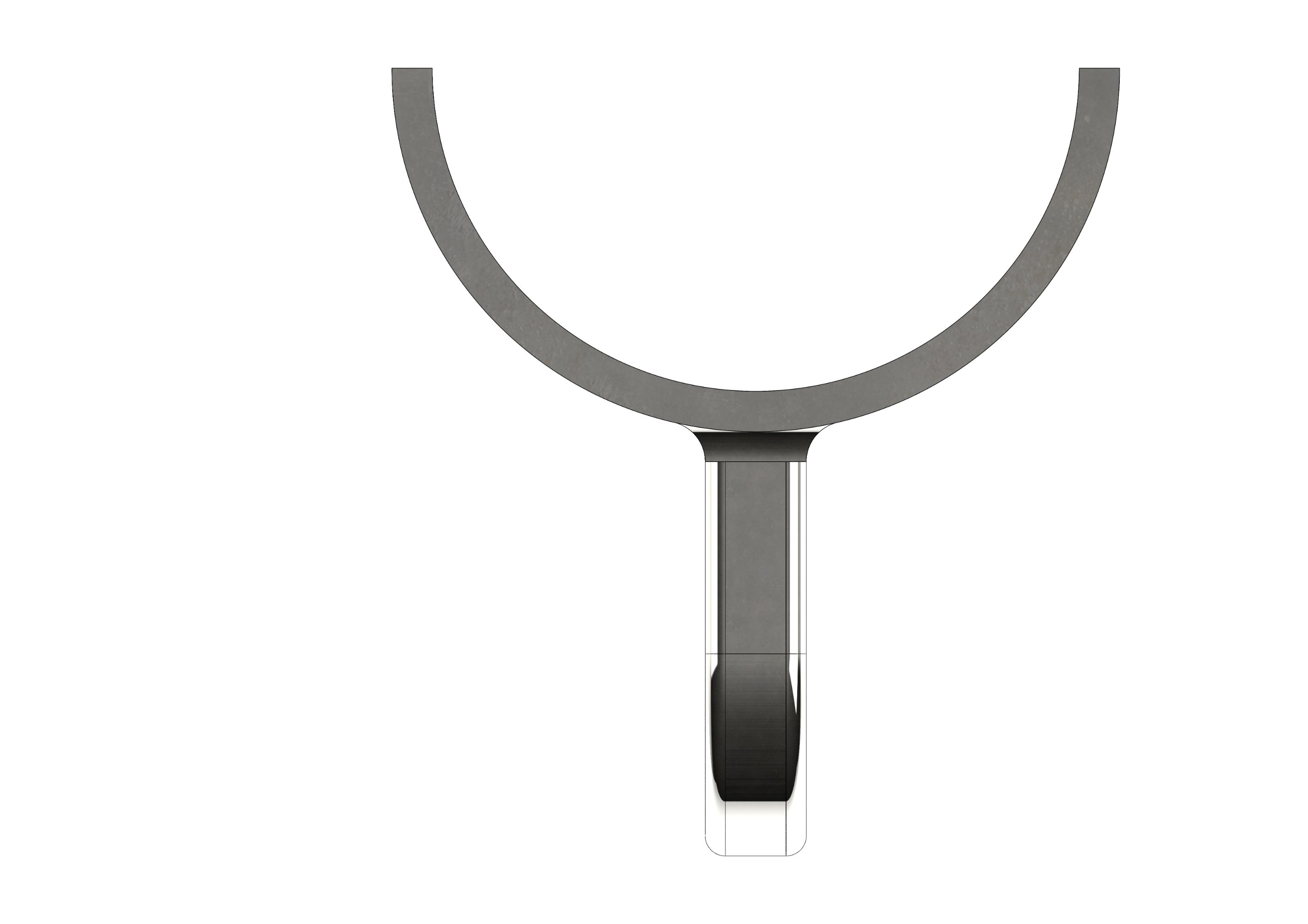

So as you can see, this time I used the manual method with combine and surface cut, but then it doesn’t mask of the hulls like it does in the mould feature.
It seems like I have a problem with the fillets when I put the cut flush to one side, maybe I should go one mm in into the tap, do you know where your coworker did put the cut, or maybe he didn’t use fillets?
Could you add the fillet feature after splitting the mold part? That might help resolve the issue, maybe.

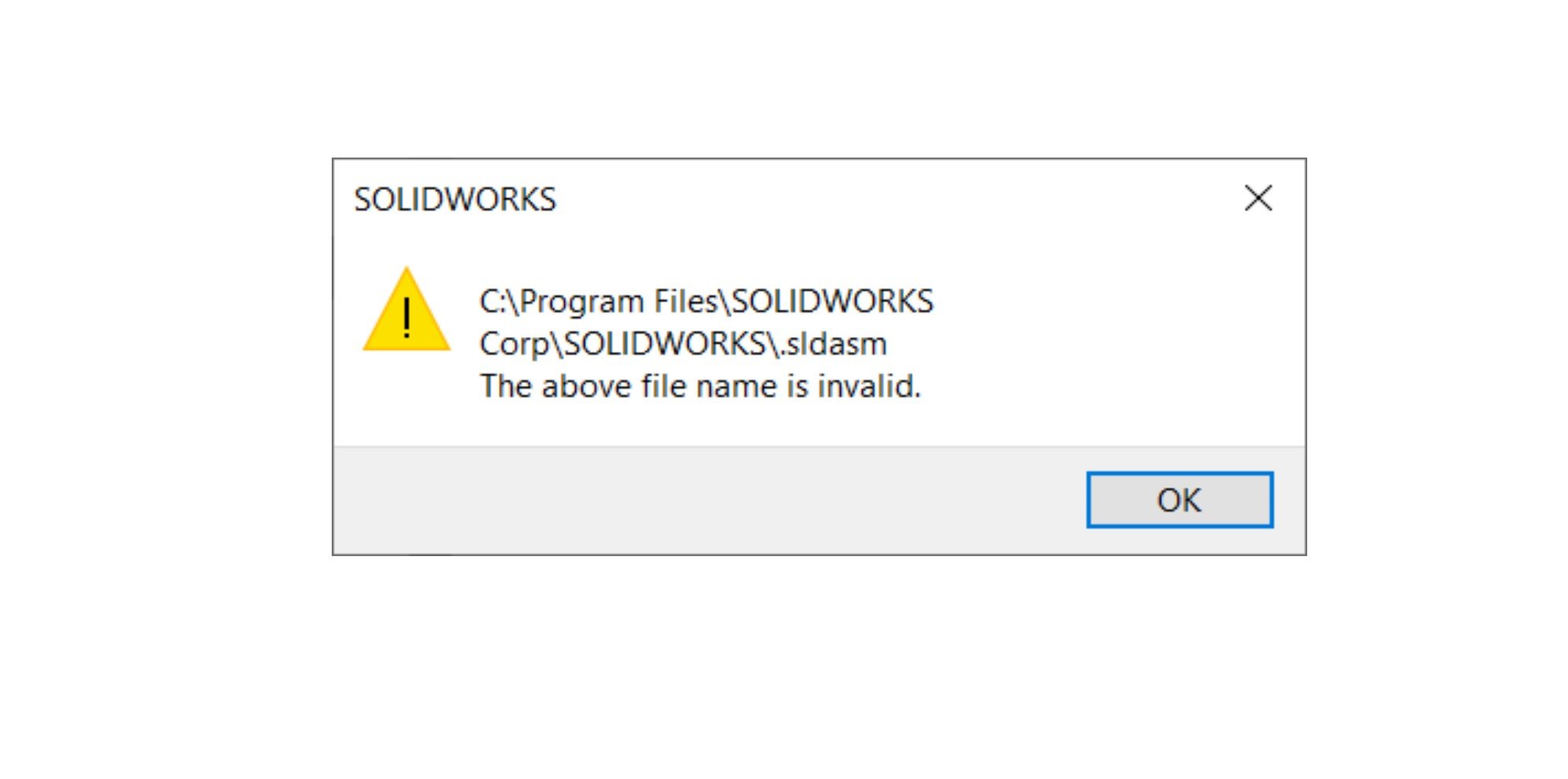

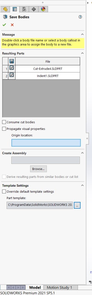

So I’m trying to save out the bodies to an assembly, but when I browse for the file location and click save, I get this error message that doesn’t make any sense. My Solidworks version 2021 is installed at default location on the c:drive. I’ve tried different locations on different drives, but get the same message. I’ve looked into default file locations in solidworks settings, but can’t find any who refer to the location on the error message. When I look at the menu for Save bodies I see there is no option for override template settings for assembly, just for parts, but in the help menu it shows that you can override both parts and assemblies location.
Any tips on how to get by this, so I can save the file?

Thank you, well yes I could, but then I think I would be without fillet at one side
To get the radius on both sides split the blue and green part so it is down the centerline of the part. The feature forming the thru hole can either be all on one side or equal amounts on each half. As far as the save issue, based on the screen shot it appears your assembly file doesn’t have a name, if it is trying to save a file named .sldasm. Just a guess.
Also, maybe it’s just me, but if you turned off the “real view” feature before creating the screen shots it would be easier to see what is going on with your parts.
We added fillets and drilled holes post processing. It was not part of the mold.
Thanks again everybody
Yes probably best to add fillets later and I also made a version where I split the mould down the middle.
No problem, I’ll turn off realview in the future, but regarding the missing name, that’s because it’s still a part with 3 solid bodies that I want to save out as an assembly, but it wont let me name it. I’ve tried just typing inn the name and browsing for the catalog, but to no avail. I’ve tried with old and new parts, same same. I can not understand why that file location is showing up when I save, possible looking for a template, but that’s not the template directory, and I never saved any files there before.
