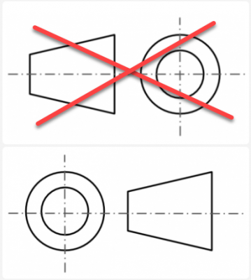

All things being equal, it comes down to what you learn or its just random and neither is better than the other. Am arguing that 1st and 3rd are not equal. 3rd is better because view location makes more sense, focused on the position to how you would look at the part. 1st angle was based on Monge’s descriptive geometry and is based more on a mathematical/projection philosophy. 3rd angle was preferred in the US to train people on and was considered easier to teach and understand.
So 1st is based on projection and 3rd is based on viewing the part in person. Which makes more logical sense to our primitive tribal minds?
Thanks for the pic, I’ll use it on my drawings going forward.
